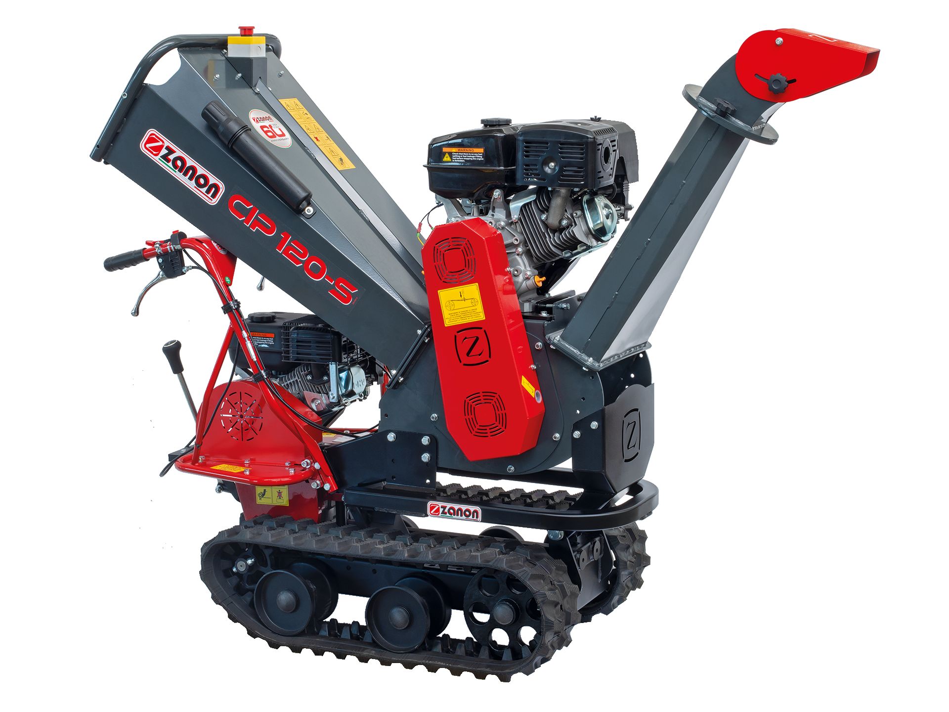

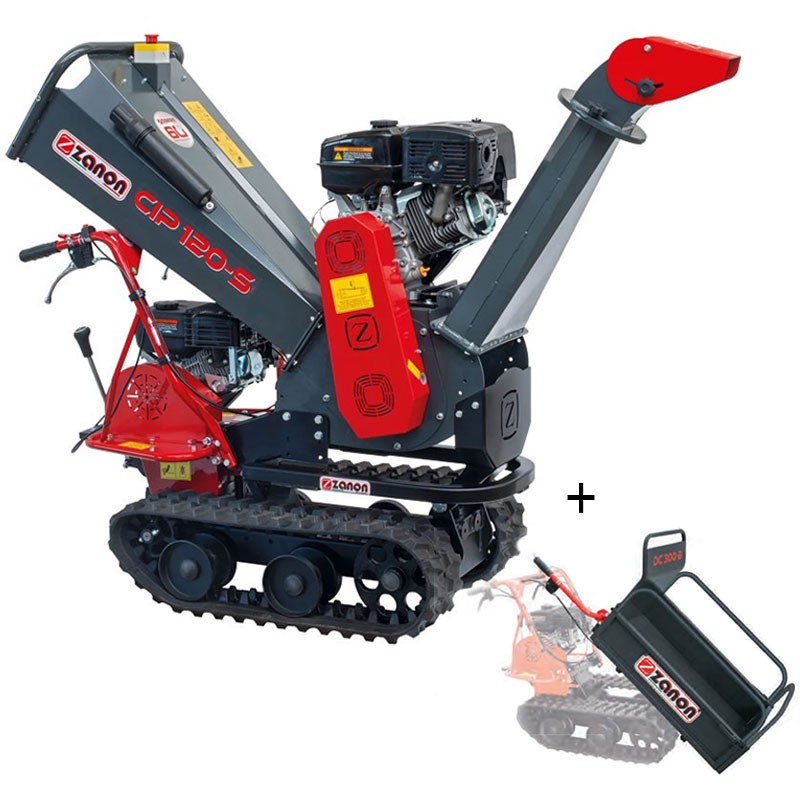

Did you see  this   chipper that look similar?
WWW.ZANON.IT
The CIP 120-S CINGO allows shredding different types of material such as branches and foliage, reducing the volume of waste by 5/6 times.
Not sure if they are really made in Italy as claimed as they seems too cheap?

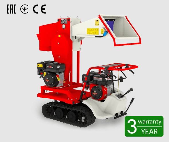

I saw those first chippers with various brands, it's hard to estimate who is the real manufacturer until you see this. I also did not want to maintain two engines and I think the center of gravity is quite high - not good for transport. While two engines may be advantage in case there is a failure on chipping engine, you can still move the machine, still you need to fill two tanks, change two engine oils...

but be prepared for a different price level, different sizes and different construction compared to OHASHI or this noname SZ130.
