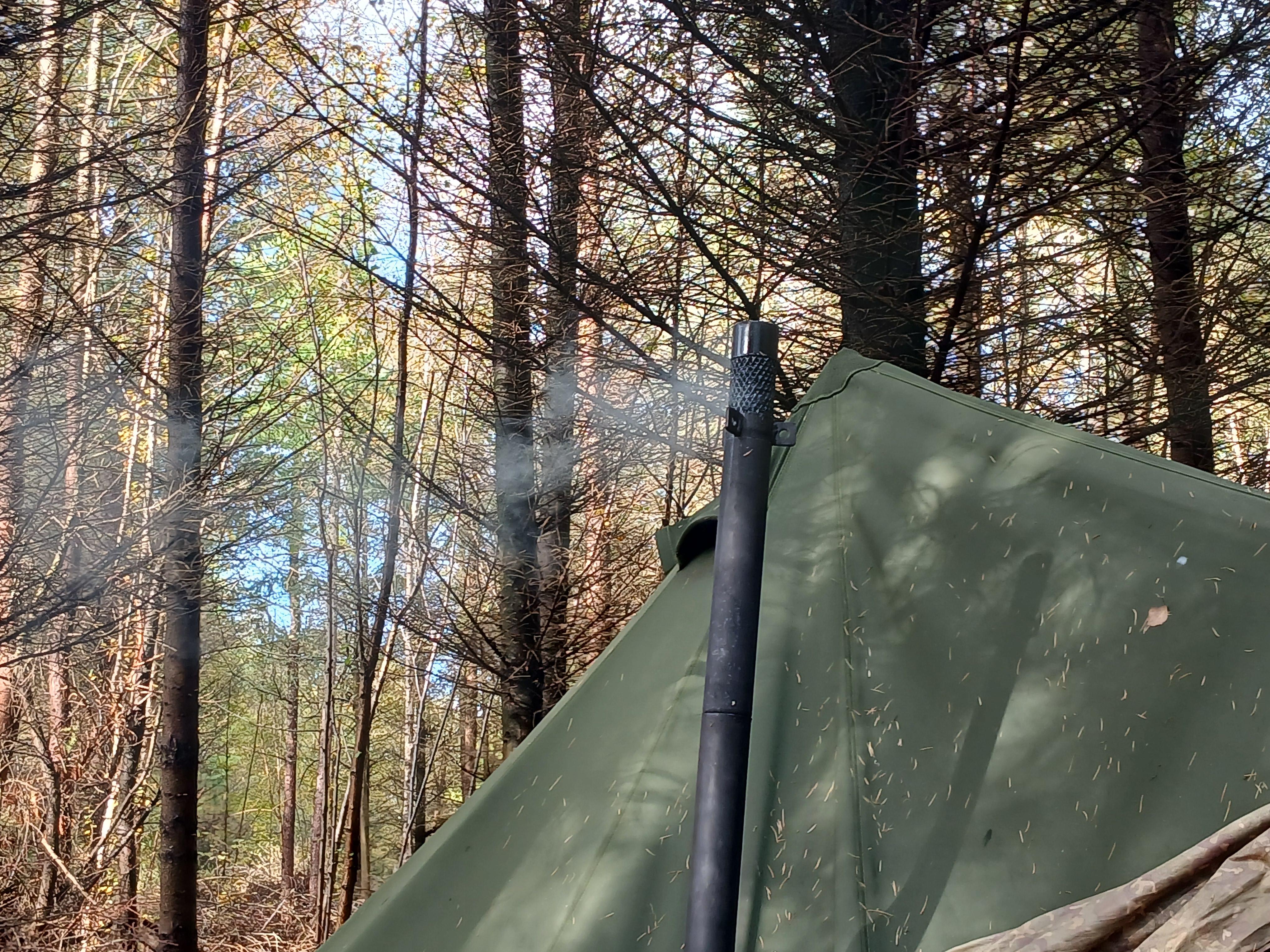

I would say you are burning wet wood, the water is lowering the combustion temperature and any flames are quenched before completely burning out, that grey haze is moisture.
Also I have seen a restricted cowl like that blocked by soot, resulting in carbon monoxide alarm sounding in the boiler room. You do use a carbon monoxide alarm don't you?

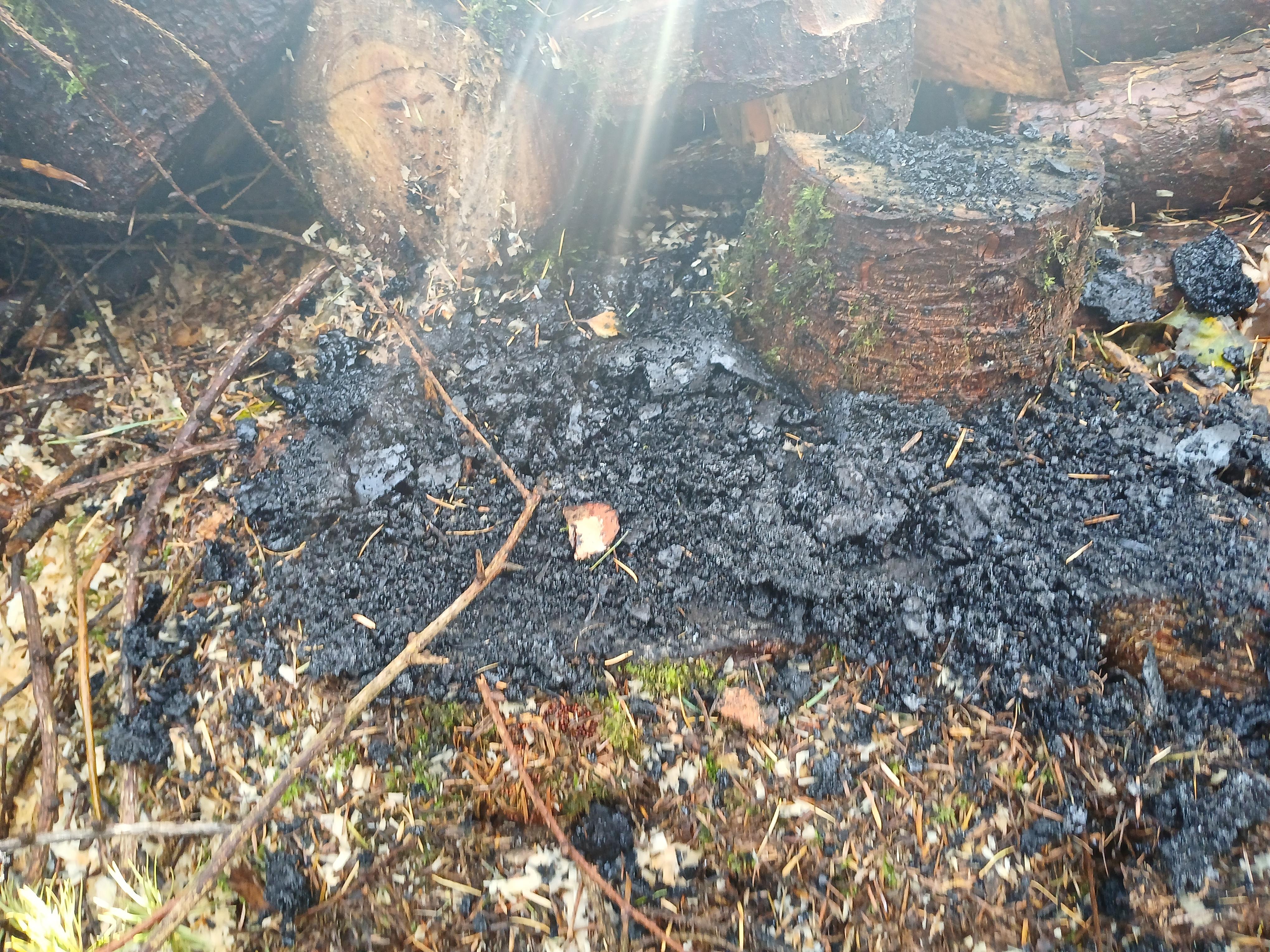

Doesn't take long to clog the flue on the tent stove, just emptied it on Friday and was clogged again yesterday
The contents of two cleans in the pic
Your wood is not seasoned .
I must have mixed some of the more recently cut logs with the older ones, I've been doing a bit of a restoration job on a few acres of sitka spruce plantation and have got logs piled up all about the place
