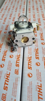

I have tried to search the forum but have drawn a blank. I recently acquired an HS 80 hedge trimmer. Looks to be in good condition. It’s not running very well. It either runs ok once started but dies at idle or won’t rev. There are only 2 adjusting screws. As in first pic. The case shows H/L for one and LA for the other. Can anyone help me with some base settings. I’ve tried 1-2 turns out on HL. Which will get it to start but the LA  doesn’t seam to do much. Just need a starting point. Thanks in advance.
Yes I understand that. I’ve set a few chainsaws up. Normally there is a separate hi and low. And a separate LA for the idle. Unsure how the high and low can be controlled by one screw.
It doesnt have a H like a chainsaw just L and idle. The standard setting for L is open one turn, then adjust idle so the cutters dont move.
If you cant get to this stage quickly or the machine isnt idling, I’d start looking for air leaks.

Thank you il try the settings first then the carb. Suspet the diaphragm myself as when running it is hunting. Just needed a starting point.
Well tried settings no go. Pulled carb to have a look. Spotted piston through port . Scored, removed exhaust also scored. Probably ram with no oil. Going to try the new pot and piston in pic. Once fitted will check for air leaks etc. hopefully all ok. My own machine and not going to have heavy use. IMG_1310.thumb.png.65703e9eebe11411def5ed4c1180e265.pngIMG_1312.thumb.jpeg.9cfe8848f3ac4b15d58c3e04f3049184.jpegIMG_1311.thumb.jpeg.8f842725b34b0148b7095d9b7b876ce1.jpeg
