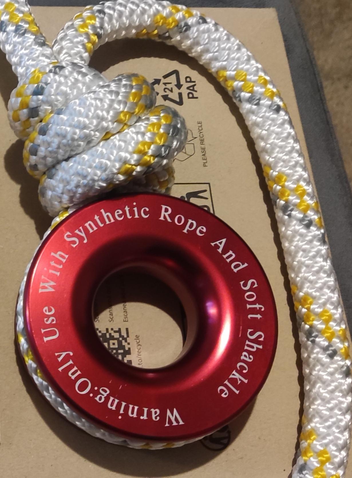

A pair of cheapy rings to fit 16mm rope. Listing claims an unlikely 20 tonne/200kN break strength!?! They are thick and heavy, will be more than strong enough for any small bits I rig.
These are intended for recovering cars, to have the rope running around the outside and rotating on a soft shackle through the middle, attached to an anchor sling. However for rigging that would likely melt the soft shackle and a chance of the rope falling out the groove, but would be fine for pulling a stem over as a 2 or 3:1 or other slow things where they might get smashed up when it lands.

What’s the working load limit in that configuration for your use?
Edited by AHPP
I'd guess at well under a tonne for a straight pull, the determining factor being that it is knotted 16mm braided polyester.  Adjust as neccessary for alternative configurations
kram doesn’t need to guess. kram can work it out and tell me with surety and confidence.

Pardon my ignorance, but I've never heard of a  'soft shackle' before  -is this basically meaning threading a rope through the centre eye ?
Also: Kram, how much do they really weigh and cost -they look like light alloy components from the photo?

I am not after rigging anything bigger than previously until I have more experience, which would give these a very large safety factor. Say 100kg for rigging tops, are the biggest I am happy rigging at the moment. I'll be getting more gear when I've done the course.
I cant seem to find dimensions listed for proper rings to compare against.
These are 100mm OD, 32mm wide, 40.8mm ID, 16mm rope groove and 13.5mm wall. 360 grams. The annodising looks good and they are listed as 6061T6. Suitable for the purpose I believe.
They might get more use for pulling on a N:1 rope system as I dont have suitable pulleys, these are much cheaper. Wouldnt be worried if they got smashed under a log.
Soft shackles are usually HMPE/Dyneema hollow braid rope with a button knot. Very strong, very static with no stretch. Mostly used for boating/sailing.
Rings were 12 quid off amazon, likely stock clearance as I got the last two.

As with anything, import gear may not be as good. HowNot2 has some testing on import dyneema and soft shackles, they were better than expected, same with most metal gear.
I think in nearly all cases, your nerve will fail a long time before any of those slings/rings even begin to get tested.
