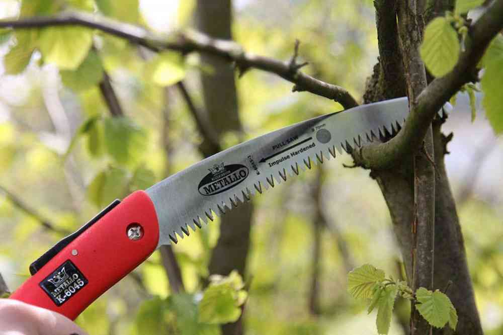

I see they also do a ARS/Metallo pole  lopper pole head with claimed 50m cut
WWW.METALLOTOOLS.COM
Prune your trees easily from the ground with these pruning elements. The K-6770 can be combined with the Metallo...
