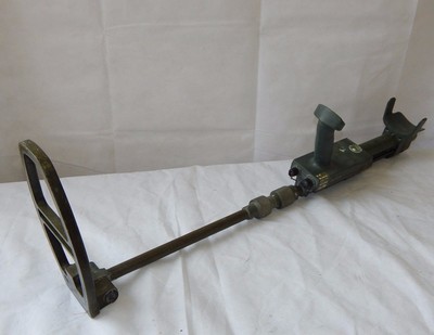

+1 for what Rough said. I have a military mine detector which will find metal quite deep into large logs but realistically its only really useful for finding screws and nails etc that are in the bark or the first layer of the tree because they're the ones you can pull or cut out easily. Trees that react with metal usually give away their location on the end grain so you can do your best to avoid them with the depth of cut.
Sometimes I will mill down to the layer I think its on and then just cut that section out with a saw. Especially if I'm using the Lucas mill because I'm usually cutting dimensional timber so it just means you have a shorter board but still a undamaged blade.
WWW.EBAY.CO.UK
Field instructions, Parts List, Headset and Test Piece Included. Search Head: 30.8 x 17cm. Water Tightness of...
I have one of these but only paid £120 for it and it came in a bag with a peli case too. I use it on its lowest sensitivity otherwise it can pick up metal in the ground underneath the logs if they're not massive.
