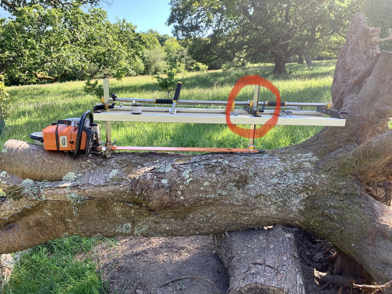

Simple concept this yet what a game changer! It's almost [but not quite] as much so as the winch - use your large mill to mill a smaller tree - there is a limit ie. would not advise a 64" bar on an 18" tree.
Set up:
  • PM-60 60" Mill
  • NEW Panther Winch set up [see other arbtalk thread in Panther sub forum]
  • 42" GB Lo Pro Bar
  • 20" Cherry
Not only can you fit the larger Panther to the small 42" lo pro bar - find assembly to do this here

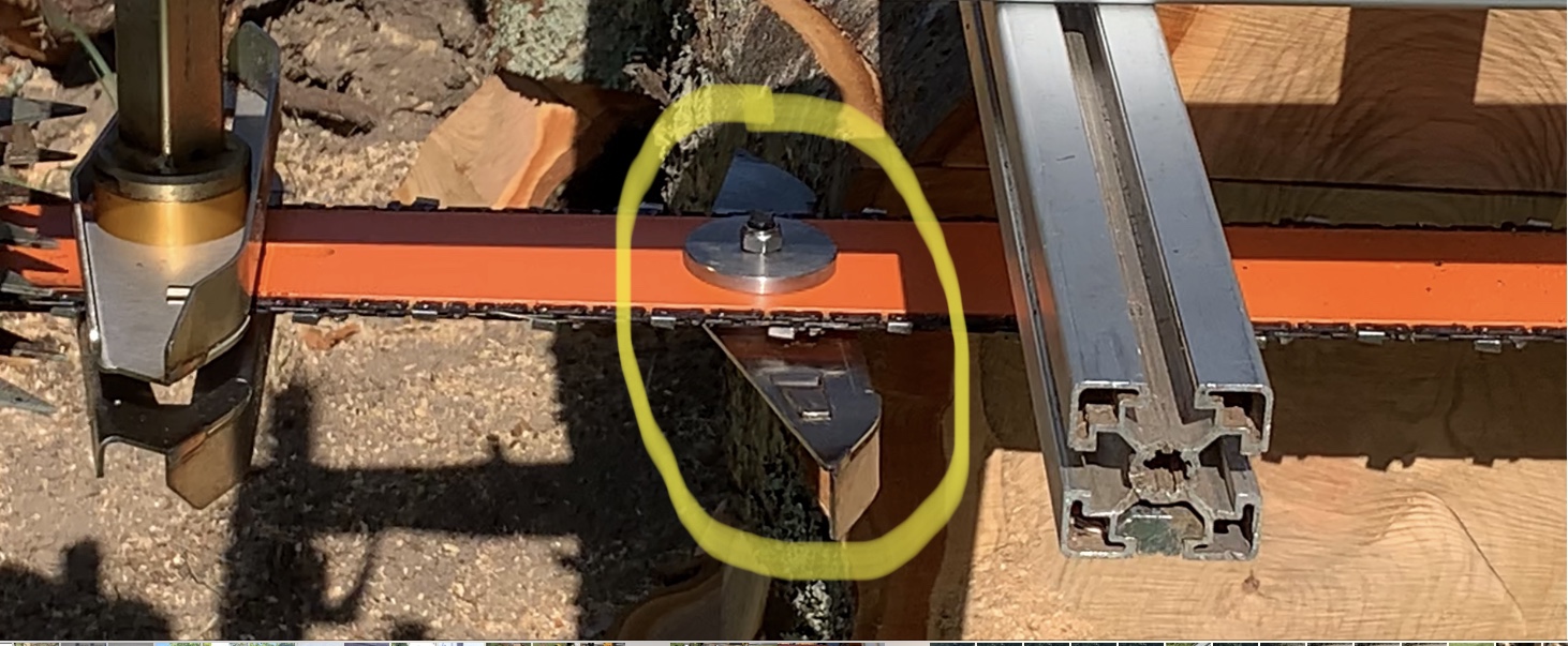

Add an additional internal skid assembly to the bar to enable you to do smaller logs find it here
WWW.CHAINSAWBARS.CO.UK
P-ISA Panther Internal Skid Assembly [Mill Smaller Logs with a Larger Chainsaw Mill]. Positioning on inside of bar allows...
