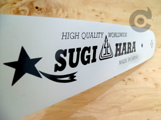

husky 325 X  is  .050 1.3mm
WWW.CHAINSAWBARS.CO.UK
[HUSKY3] BC2M-0H37P-A Sugihara 15"[38cm] Pro Lam [Quick Cut Small Nose Version] - .325 .050 64 drive links
e.g  Matching this bar
Oregon version is 95TXL
Sthil take the same chain but different number of links for same size bar so can use same chain but need different loops for each bar.....
[STIHL3] ST2M-0J37P-A Sugihara Pro Lam [Quick Cut Version] 15"[38cm] .325 .050 62 drive links
