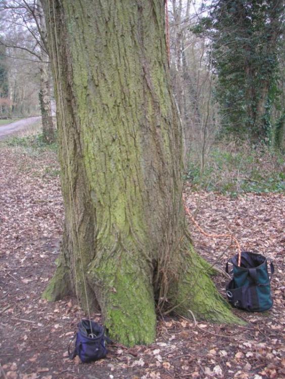

i think daves idea of having a spare throw line set up and sitting in a chalk bag on the floor is the business, if it is easy to do then it will be done more i think:001_smile:

short of conifers & little trees I allways have a seperate line up the tree even if i don't use it to access the tree is it really so taxing??????????? 5minutes on each job & it soon becomes habit! It also allows you to retrieve stuck rope guides & cambium savers should they get stuck or take the guide out 1st & use a static system to desend tree on rescue line
Tell you what every1 on this post try it out for three weeks & if you still can't stand it then suit yourselves but i bet that for most it would become habit on any tree which warrents it?

I like the idea of a second rope over the installed throw line.Having the rope pre installed means there is no chance of the throwline coming off the end of a rope in an installation attempt.For me,tying a few half hitches in the cold is bad enough,cold,tired,and in a hurry would mean an even greater chance of losing the Rope off the throwline.

Fair point Mike.
Most but not all our ropes have spliced eyes, which will make it less risky to attach.
Been trialing it with all the climbers for the last week or so.
Keeping it simple should make it become habitual.
But the line can get in the way of dropped or lowered brush :thumbdown:
Guess that's really about pre planning routes etc.
Will swap over to spare rope in a week or two to gauge the difference.
