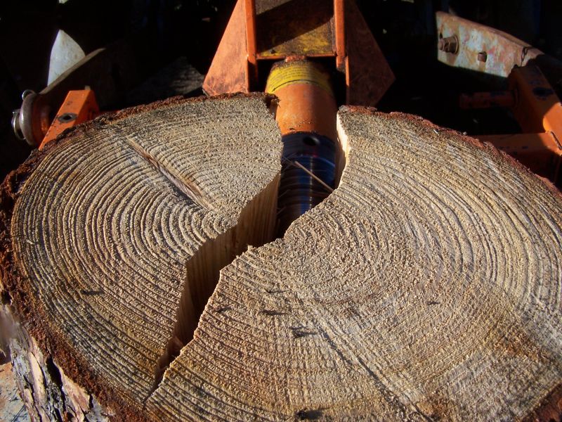

hi, just joined the forum have learned tonnes already. bought a hydraulic log splitter for the tractor a couple of years ago but have recently seen videos of the unicorn spiral log splitter. was just wondering which is better - unicorn seems to be much much faster but probably more dangerous to use. any thoughts greatly appreciated. thanks

In my experience I've found the screw type splitters to be dangerous and unreliable, forever bending shafts. Hydraulic splitters are much more civilised! Certainly don't get rid of a hydraulic splitter for a screw type.
I'm afraid that I have to disagree, I got rid of a hydraulic one for a Hycrack quite a few years ago, and I think it's a far better machine. For a start, you can use an old tractor, anything from 25hp upwards as you are not relying on hydraulics. It might not be as quick as a hydraulic overall, but in certain woods it is actually quicker. One benefit is that, because your arms are not flailing about like a whirling dervish pushing and pulling levers, it is much less tiring.
There is no ring that it will not split, and if it does not get through, it's because you need a new tip. I have only had to replace one so far.
many thanks for the info. i tried typing 'unicorn hydraulic log splitter' into the search box to find previous conversations on this subject but my thread seems to be the only one coming up.
Screw type splitters can grab the wood and throw it. Whatever is in the way gets damaged! We have a HP with a little screw splitter and I've used it twice. Both times in nearly broke my thumb! I'll stick to my hydraulic one!
Aye the unicorns are ok when the wood is seasoned but for if not it sometimes spins in the ring. Ive sold mine for a hydraulic as its safer and more efficient IMO
