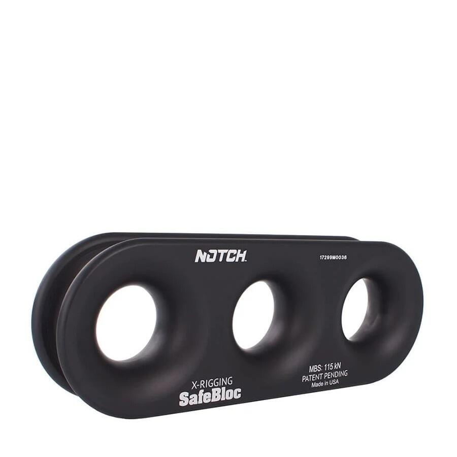

Things like this do the same job but more expensive:
Notch Triple Hole X-Rigging SafeBloc - Black
