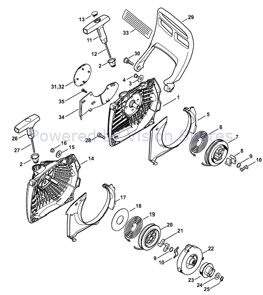

So the broken part is no 14 in this diagram, the cover with the fixed shaft. 22 and 23 are the spinny bits and are retained by 24/25 that sit in the broken circlip groove.
The shaft has a torx end but looks like its only for assembly purposes?
Does the shaft remove from the plastic cover?
I might be able to repair that easily, or turn a new one on lathe.

Correct! It has a torx end but I didn't see a purpose, I haven't stripped it down fully yet as it didn't show a replacement shaft on the parts diagram. What I was looking at doing was to bore the plastic starter piece (number 23) down by 5mm or so and machine a new groove in the shaft for the clip. Next job is to see if the shaft can be removed or is moulded into the cover.!
