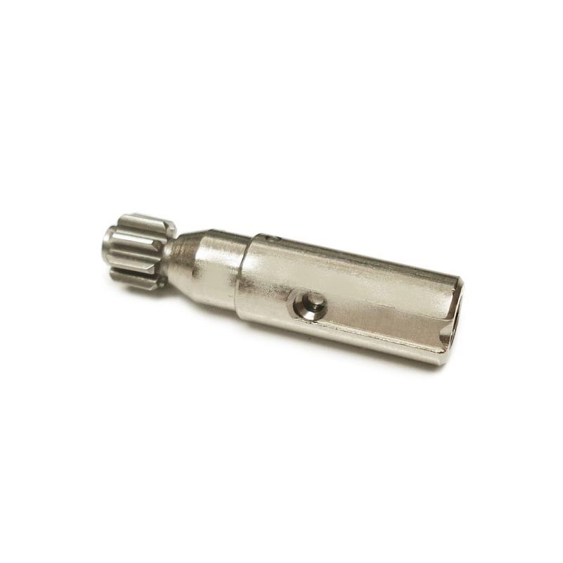

Is the metal pump inside the plastic like this
1123-640-3201-pompe-a-huile-0-65-pour-tr
If so you should be able to screw an M5 or M6 pan head screw in and tap it out with a slide hammer. It is very important to line up the inlet and outlet ports to the plastic housing when you put it back. They were about 15 quid when I last fitted one to a petrol chainsaw about 9 years ago.
