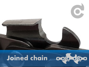

For Chains there is a whole range of Milling Chain out there. Id get something like this;
WWW.CHAINSAWBARS.CO.UK
Special Rapid-Micro horizontal saw chain, primarily for use in conjunction with horizontal cutting devices as well as mobile small sawmills.
You need to check what pitch that bar takes etc.

A proper ripping chain from chainsawbars will give a smoother finish but your normal full chiz will give decent results that will just need a bit of tidying t get a nice finish.
