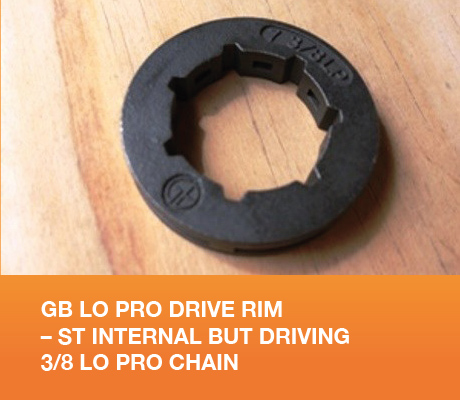

So who does a large splined 3/8 rim with a narrower gauge? and why? certainly a new one on me.
We have these custom built for us by GB [I think there are others but harder to come by]...
WWW.CHAINSAWBARS.CO.UK
Exclusive Lo Pro Drive Rim to it saws running rim sprocket setups - standard internal fitting. Rim fits onto drive sprocket...
