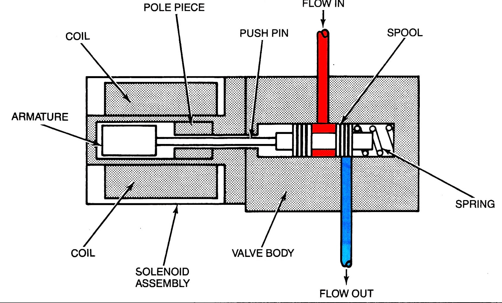

Hi I have a 1997 entec chipper always been well maintained really good condition. Just that the no stress hasn't worked for a while. But want to get it working again could anyone help also what is this part that is. Something to do with it I think...
[ATTACH]214131[/ATTACH]
Put power on to it and shove a nail or screwdriver up the middle, if it working you should feel a magnetic pull. If that piece is working then the activator pin in the valve might be stuck, that should also screw out.

Just a little caution required with a solenoid coil, if they are powered up without the iron lump inside that does the actuating, they can consume too much power and burn out. Use a circuit tester instead, if it is disassembled.
