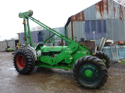

Good spar to give height and tower at tractor end. What winch are you thinking of using?
Old Jones leaflet here courtesy of Forestry-Memories.org.uk

That takes me back to those early APF shows where Jones would have a skyline running and Highland bears forwarding the produce back to the end.

Thanks for the replys.
I have an old Fransgard 3500, which is only 3.5 tonne but I am looking into a bigger winch for more pull and more cable.
I am going to have a play around with it in the next couple of weeks and see what it's capable of doing. I will put some photos up.
