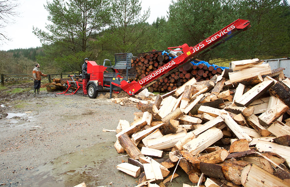

Been processing a mixture of seasoned Scots Pine and fresh cut Larch for a biomass boiler.
Couple bought a 25ton load and want it processed this weekend. Easy enough job especially when the split length is 500mm. Only downside about the job is the constant rain, sleet and cold wind, but this is mid Feb inArgyll

We're lambing on the farm at the moment so we're cutting 6 days a week to try and keep up with orders, luckily our new processor is going well and we've got some nice big straight wood to cut. Just struggling to dry it fast enough now because everything's so wet.
Hi, how's the new machine?
I'm on my second 400
It's working well, overall it's just slightly faster than the 400 but obviously the real gain is putting bigger logs through and the 12 way splitter means you don't have to put anything through twice.
Having three rollers on the log table is a huge improvement and the hydraulic winch on the conveyor makes filling boxes easier. The chain is slightly easier to access but the sprocket is harder.
We've got the plus model and the auto height adjust on the splitter is nice but not important with the 12 way in. The splitter is the same speed as the 400 but slows down if needed on big logs, it does make our massey 35x struggle though. :)
