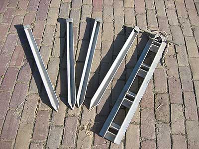

The anchor screws in, ex-military, getting like hens teeth these days as they're worth more as scrap due to their weight. I also have a drive in one but its only really suitable for self-recovery or a light pull.

Yesh to the ex military ones -tho tbh all u need is a length of 6mm angle an som 16 re-bar for pins, burn 8 holes down the length of the angle faces, cut the re-bar to 3 foot lengths -get the torch on it an curl som loops on the end ( so you can pull em out) then weld a big eye on the angle iron, for yr tirfor-an thats it
Lay it in the direction of pulll an hammer the pins in at angle suggested by the angle - iron an if that moves -I'm a Welsh man.
