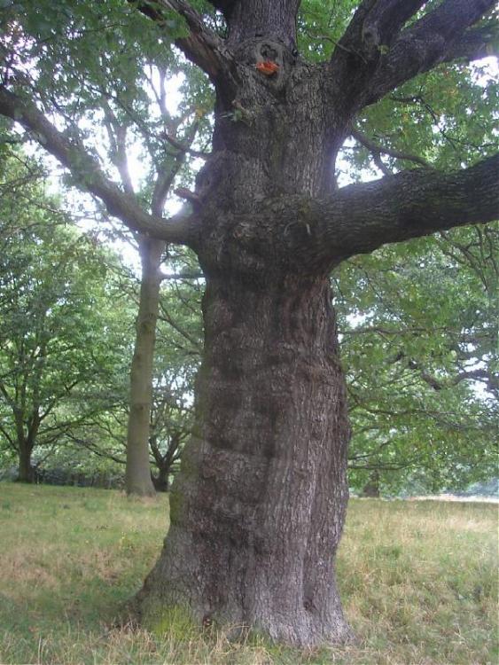

Is the exudate a major clue to IDing this one?
Just answered this myself looking at monkeyd's reply to vdubens ganoderma???? thread - though have to say those and other pics I've just seen have sall spots coming from pores, whereas the pics above look like egg wash baked on pies (if you know what I mean), is this because it is immature?
Thanks guys. I just looked at soem other photo online and it looks different to inonotus dryadeus, but descriptions sound right and its common on oak.
I'll go with that unless anyone has any other ideas?
Seems a slow death is ahead for this tree!? That area of bark in the picture is quite new its covering a large vertical scar which has wood pecker exploration holes at the top, so some soft heartwood is already present. Its overhanging a road on an estate open to the public. Will program it for removal.

Again, its on an estate, but overhangs the main road, so its coming down tomorrow.
I think as Innonotus ages, it drys and goes black.
What you have on your ash is king alfreads balls, can't remember the latin. Once you see that on a ash there's no going back.http://www.arkive.org/species/ARK/fungi/Daldinia_concentrica/more_info.html
I. dryadeus is a butt rotting fungus. I don't think it necessarilly kills oaks, but it can weaken them and lead to branch loss. I saw it recently on an old oak pollard in a car park and it was decided to retain the tree, but re-pollard it to remove the danger of large branches falling off and also to reduce wind leverage, so the stem won't snap. That's the plan anyway.
If it's an Ionotus 30ft up in an ash tree then it's more likely to be I. hispidus.
