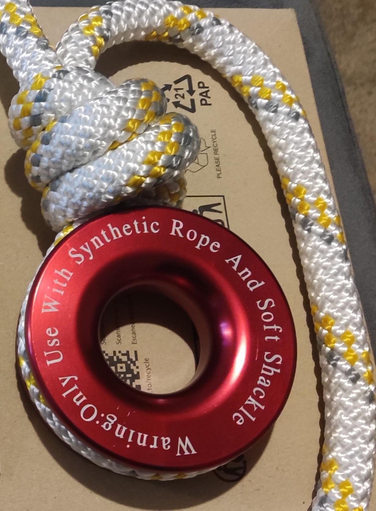

@AHPP Ok then. A claimed 20 tonne or 200kN MBS on the ring, gives a 200:1 safety factor for 100kg load.
The 16mm rope is rated somewhere around 40kN, half that for the knot, is 20:1 SF. However I might splice one of them in which case I can say 30:1.
As I said before, I wont be doing anything big, small stuff only until I have more experience, done cs41 and get better gear.
This is great. You're thinking about it.
Have another look at the 16mm rope section of your deliberations. It has a minimum breaking strain of 40kN. How might you arrive at a working load limit or safe working load for it? Walk me through it like I know nothing.
And you were talking about a 100kg top. Remember that if you've got a 100kg load hanging on one side of a ring, you've also got 100kg the other side of the ring too, on your portawrap or whatever. So you're not putting 100kg on the ring and deadeye (and rigging point). You're putting 200kg on it. And that's only statically. It's more force if snatched (do you know how much more force potentially btw?). And that's on both sides of the ring still.
A 100kg top is a huge top btw. We can do the sum later. Get your ring and deadeye capacity worked out first.
Come on @kram. We were making progress. And people watching might be learning something too.
