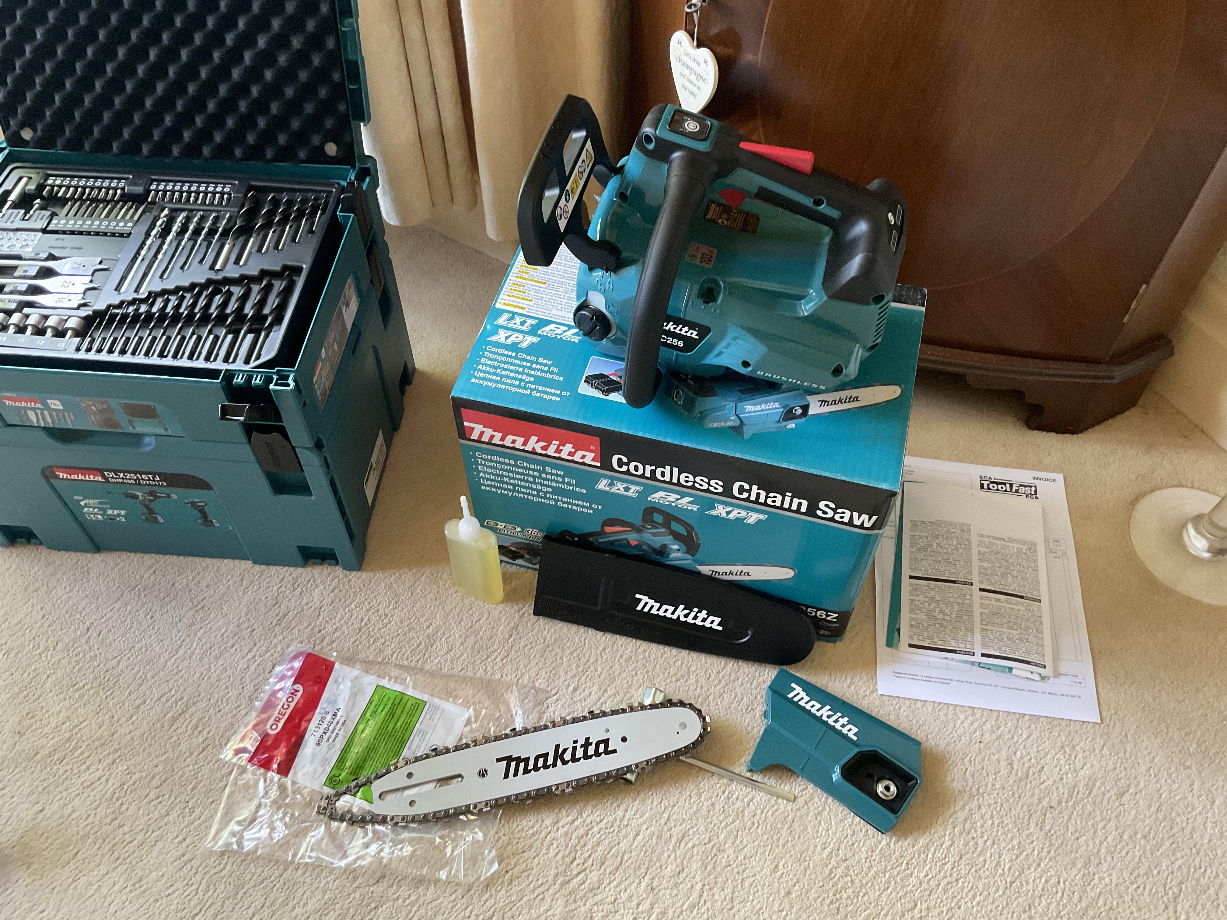

I bought the saw in the title because I already own Makita 18v kit with 5.0ah batteries which are compatible with the saw in question as it takes two of them in series. It has a 25cm bar and seems a very solid bit of kit - I paid around £140 for it brand new from an authorised dealer and was attracted by the compact size and weight and 3 yr warranty - granted it might not be the choice of the professional, but for me as a home user, its seemed like a good deal and it was a fraction of the price of a similar “body only” 36v rear handled Makita.

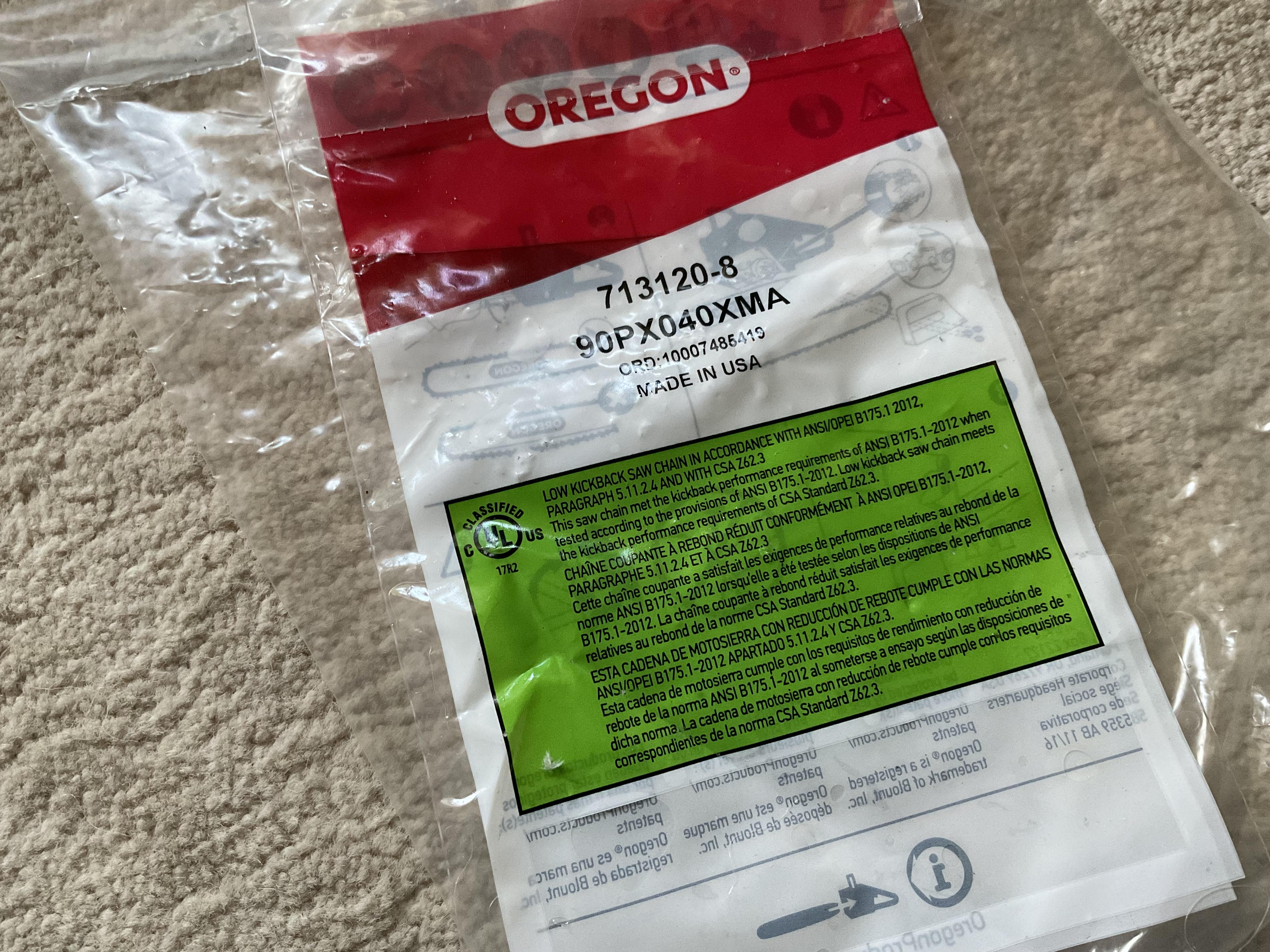

I noticed that the Oregon chain that came with the saw is a low kickback type, so should help I guess. Also not cutting with the tip of the bar is duly noted. I’ve been reading up a lot and trying to learn as much as possible, so every nugget of knowledge is great to share.
