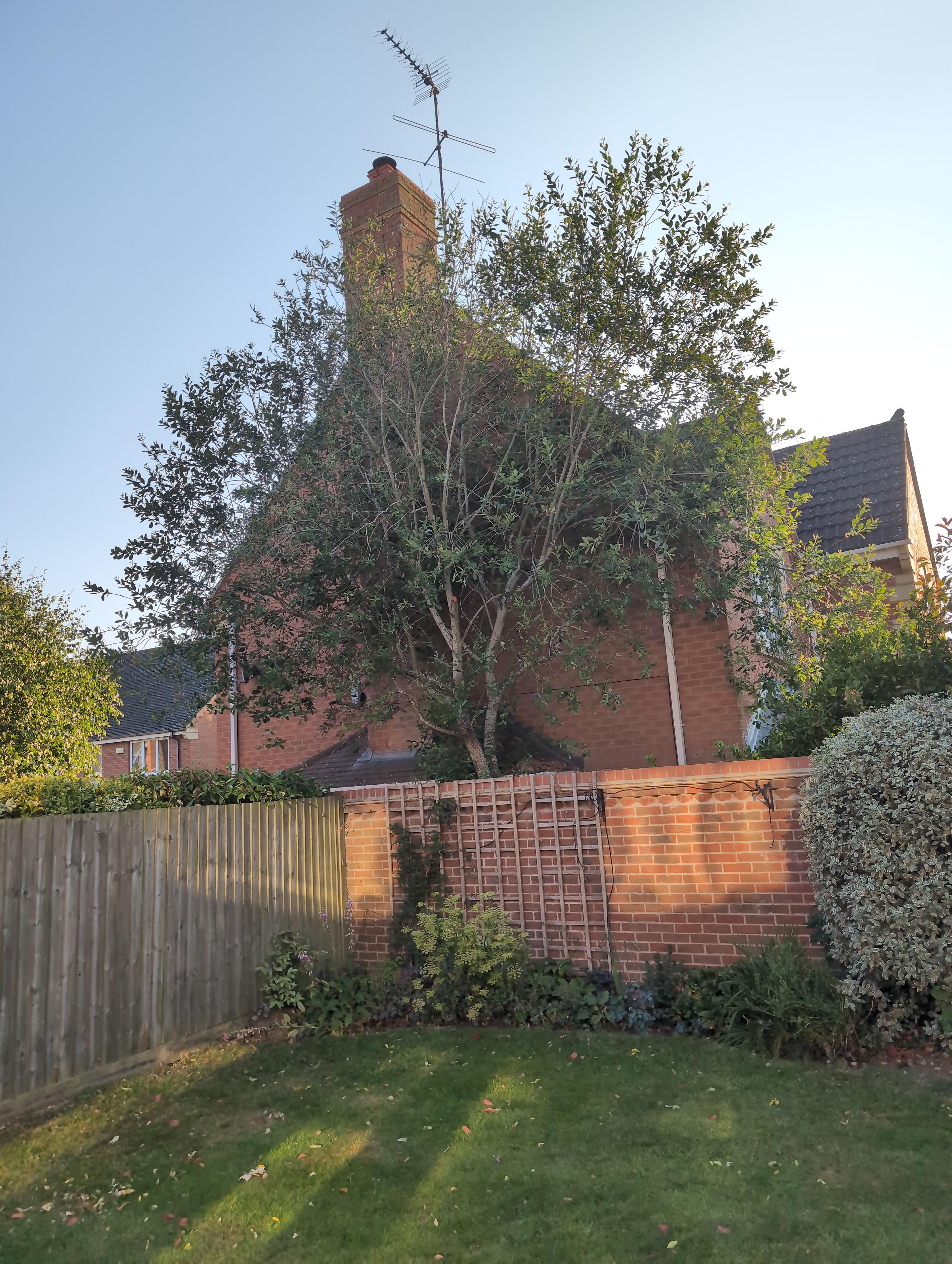

We're growing a bit anxious about a goat willow located fairly close to our house. If anyone out there can calm us down that'd be appreciated!
We're based in NW England on what I think is clay soil (SK4 3PG). We have a mature goat willow located 14 metres from the rear of our house (14 metres from a single storey extensions but in 2029 and 17 metres from the original house).
We haven't noticed any concerning cracks or anything in the house, but have become concerned that the proximity of the tree may cause us problems in the future. Any ideas of what to do? Prune fairly regularly to keep its size manageable for example?
I've included a photo below. It looks to be about 10m in height. The right side appears (which would hang over the neighbours fence) appears to have been chopped back quite heavily over the years. There is also a large branch that appears to now be dead (the section without any leaves on). It appears to have been insitu for at least 30 years as Google satellite from 2005 appears to show it as a mature tree back then.
Any ideas welcome. If someone can suggest that risks of future subsidence are very low that would be appreciated! If you would recommend we get a soil sample etc done then recommendations for someone in the NW would be appreciated too.

Nothing to apologise for.
Willows are the Rasputin of trees. Short of separating its molecules and salting the earth, you won’t kill it. Hack it any way you like. It’ll grow back. The Welshfred plan sounds good to me. Bit of space to stoop underneath.
Can’t help you with the house proximity besides an utterly anecdotal looks fine to me.

House proximity... if it has been there 30 years and the extension for 17 a competent builder / architect will have accounted for it (however....)
As above, hard to kill it off, poison, keep going at it taking off all the new shoots as they appear or stump grind the roots and hope. Even the logs taken off will sprout roots and shoots if left in a suitable place. I'd look at managing the tree as well.
