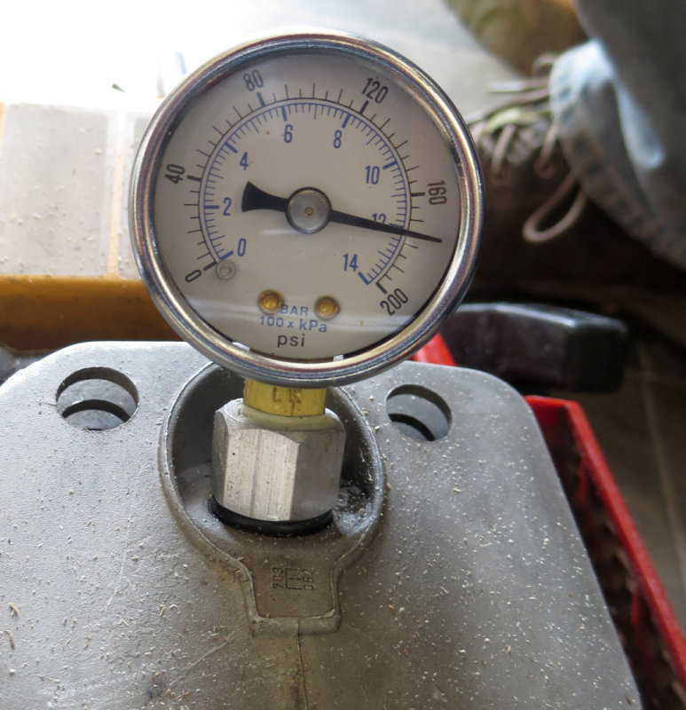

These are both on the same Jonsered 2165:
Proto:
Mercury Marine(tm):
TThe Proto is a quality tester, but it is at the end of about a foot of tubing. Because the Mercury tester is so short, it won't fit on many saws without completely removing their covers.
Nice example there wyk, and that's a 65 cc saw. Presumably that was enough pulls for pressure to  reach a maximum. Where's the valve on the Procto, which end of hose ?
200t is half the capacity (near enough), gonna have bigger effect.
Edited by bmp01
Typo
Interesting with the difference with the hose. I installed the genuine buffers today and it feels a lot smoother. The non genuine mounts are almost like car tyre rubber, the Stihl mounts are far far softer. One annoying thing happened though. I had to take the fan cover off to do the bottom mount and when I put it back on again one of the course thread screws that goes into the fuel tank threaded out. I'm so careful with them too, I turn them counterclockwise and feel for the thread and then torque them down to the spec from the manual with a calibrated torque wrench. I'm going to drill the holes out in the tank and then install some threaded inserts and install some m4 screws to match the front so I can take the fan cover on and off as much as I want without issue.
You can fit a larger self tapper. I think the one from the very top of the recoil cover from a BG85 is shorter and fatter and fits nicely. It is the one nearest the middle of the top handle.
The Proto valve is in the neck, just out of view. The Mercury's is the valve itself. Like a presto bicycle valve, you simply press it and it discharges. It will always test higher than a hosed tester. I like it because it goes to nearly max within 3 pulls, and the first pull forecasts how the saw will do as it will go to nearly 1/3 what the max will read.
I rarely have to pull the Proto over more than 6 or 7 times to reach max compression. In any case, as Spud will attest, most experienced techs can tell a chainsaw's compression simply by turning the engine over, guessed within 10psi. But sometimes ya want proof - like this test here after I ported that 2165, removing the gasket - proof it made a good difference from it's previous rating of 175psi up above:
