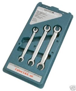

Should be a simple job to take out the grease nipple / bolt & push the idler back in. But the hole that the nipple is i is so small & the bolt so close to the side of the box its in that you can get a spanner on it & the angle stops a socket getting on it. I am guessing that there is a "special" tool to do the job. Poss some thing like a supper slim crows foot spanner on a socket extension.
Any ideas?
Well sorted that problem. The thing that the bolt / nipple mounts in had twisted. Bit of leverage & it was in the centre of the hole so could be got with a socket.
