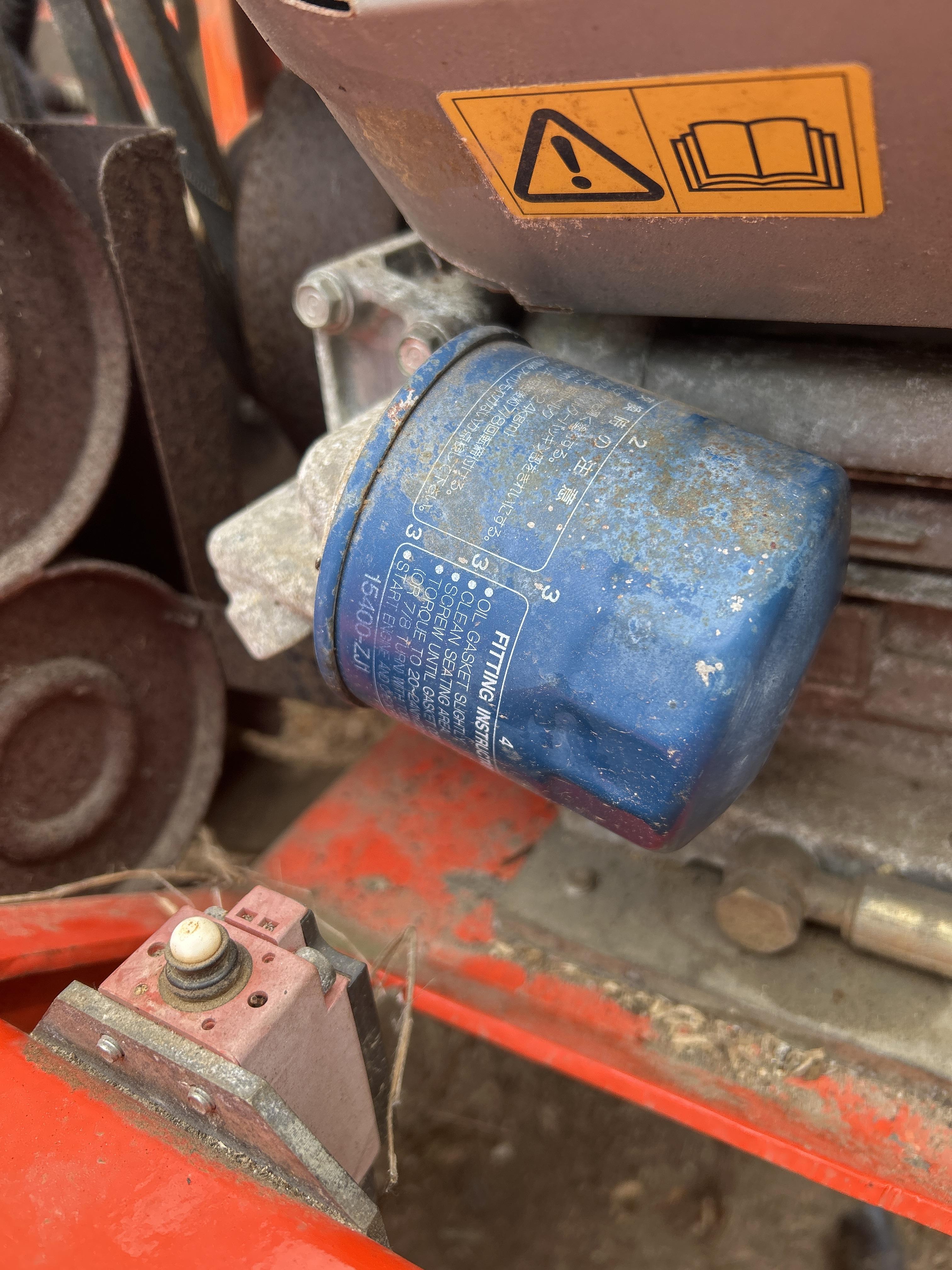

Think it's on other side of engine. That's a pressure switch in picture you haven't been trying to start it with that not pushed in.
That's an hood interlock, but yeah.
If the oil switch is fitted it's a oil sensor not pressure.
Probably equally low down on the engine block, but maybe change your filter with the engine oil as that looks old enough to be OEM from when it was bought!.
