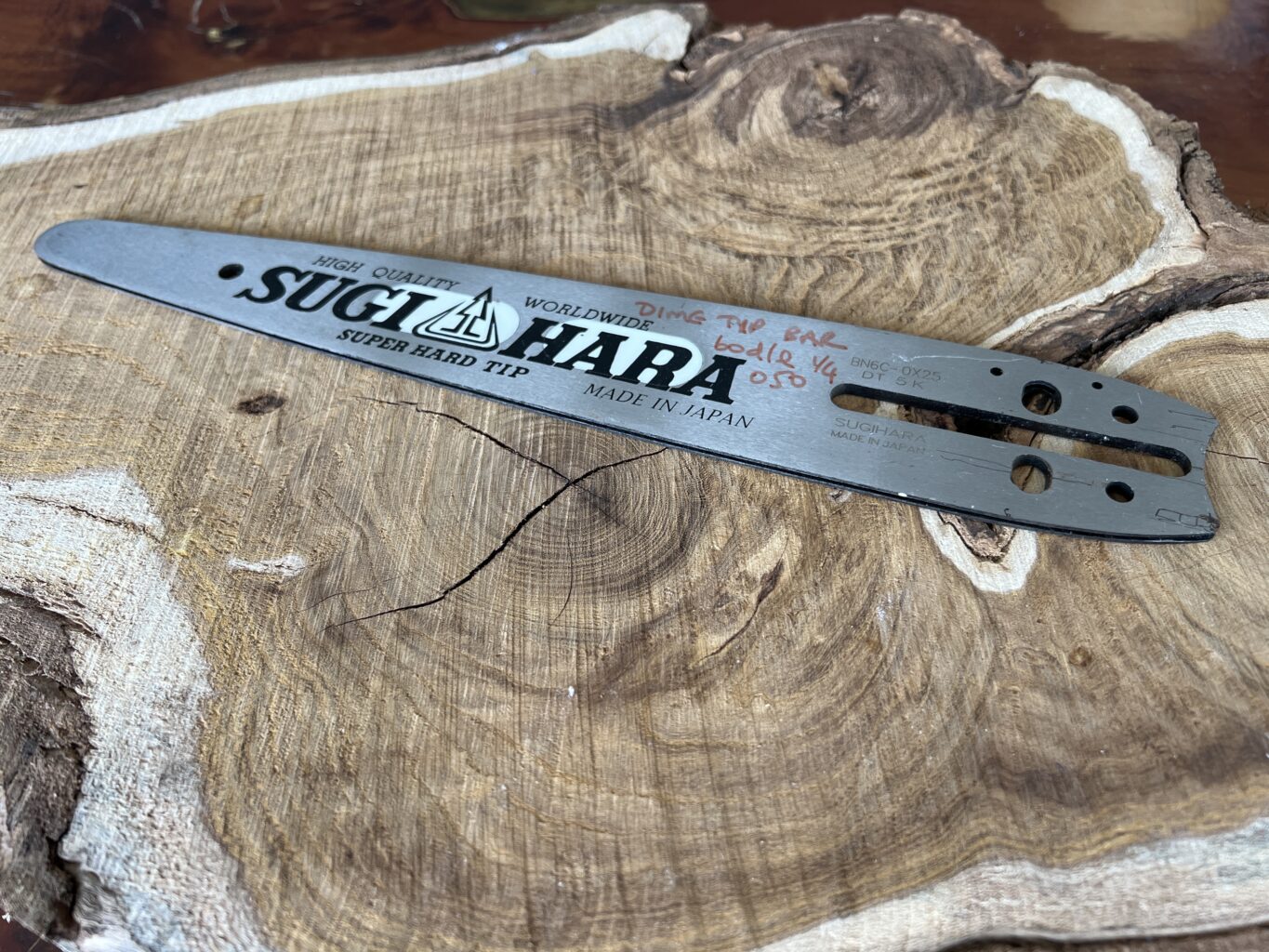

He did supply a kit where you could replace the drive drum with a 1/4" drive
Mine came with a 10" and 12" sugihara bars and chains. The 10" had a "dime" tip and is perfect for cutting out holes in chestnut posts.
It wasn't cheap but it transformed my 1999 - 023 into a very, very useable  tool.
