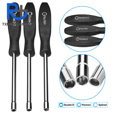

sorry for all the questions.  in that youtube he says pacman type but is that standard or small?  although i didn't notice a slot/spline....hmm, one of these?
WWW.EBAY.CO.UK
LED String. 1 Double D Screwdriver. 1 Pac Man Screwdriver. 1 Splined 21T Screwdriver. Application: Carburetor repair tools. Steam brush. Makeup brush. Motor Drive Module.

Only have ever adjusted the idle screw as the H & L need some type of special screw driver as mentioned above
