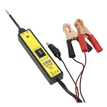

By far the quickest way to check out problems like this is with a tester like the one below. It will indicated whether on a + or - and with the rocker switch can supply both +or- . I would start at the solenoids on the engine just to make sure the hydraulics are actually working, work your way back from there.
Bob
https://images-na.ssl-images-amazon.com/images/I/41RsOabgzYL._SY355_.jpg
