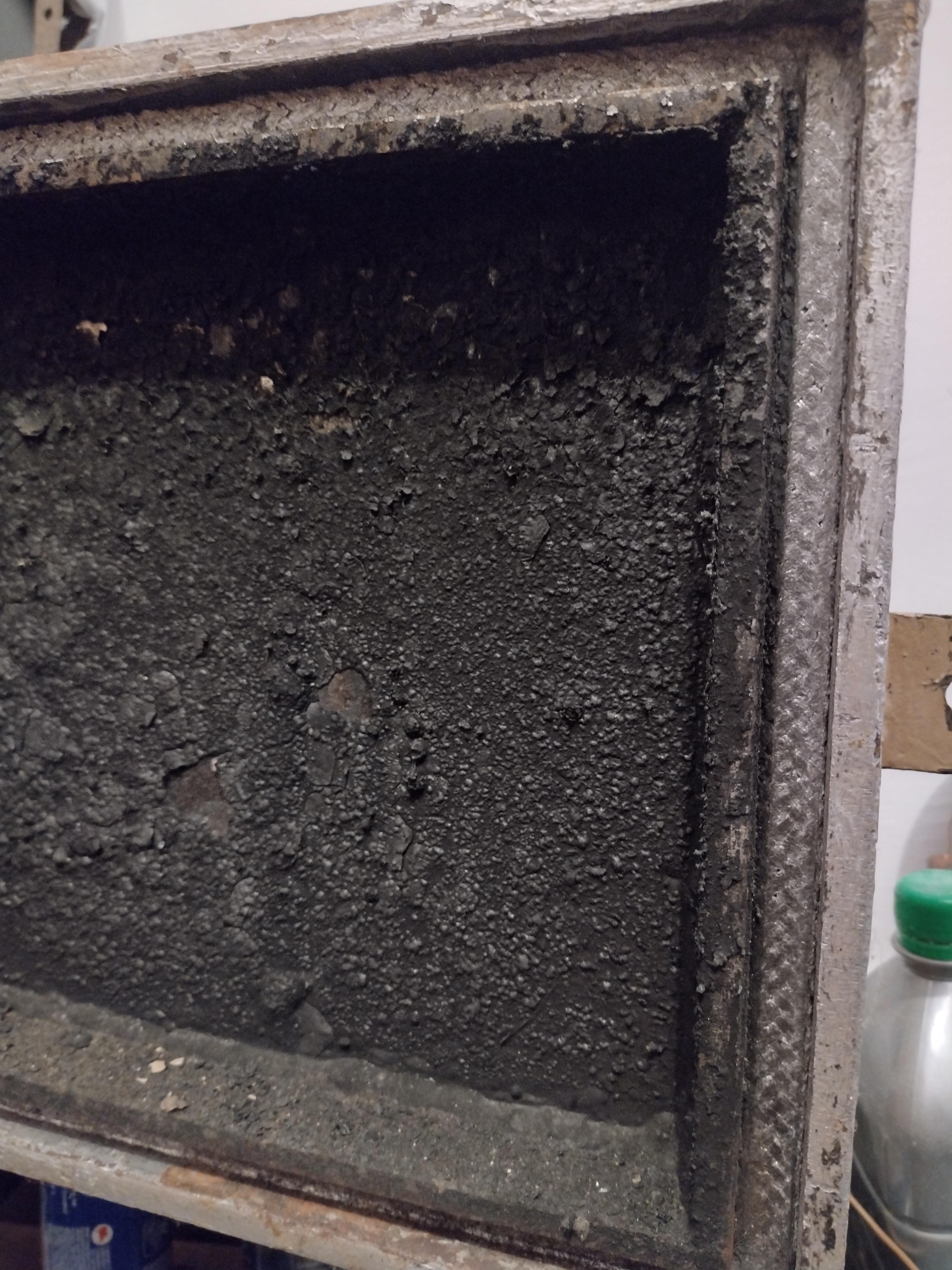

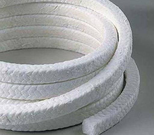

This is one solution ,second one is having doors wich close hermetically with the help of a heat resistant ceramic fiber packing(usually square white or black).
Only on the smaller stove shown in photo I have installed this chimney plate valve.
IMG_20251113_144024361_HDR.thumb.jpg.1cea95ef4778bcbce33a1d1028172aa0.jpgHere's an example using that kind of square packing.
This one is a 40mm thick steel door to a stove  that burns almost anything and survive 😁
I once got it red cherry hot because of... too much coal.
Also the walls are from chamotte brick 64 mm thick 120mm wide and about 230mm long.
Basically the walls of the stove are 120mm thick ,its all built out of 1200 degrees Celcius resistant chamotte bricks.
I think it weighs about 1 ton.
Took me a whole summer to build and it was expensive.

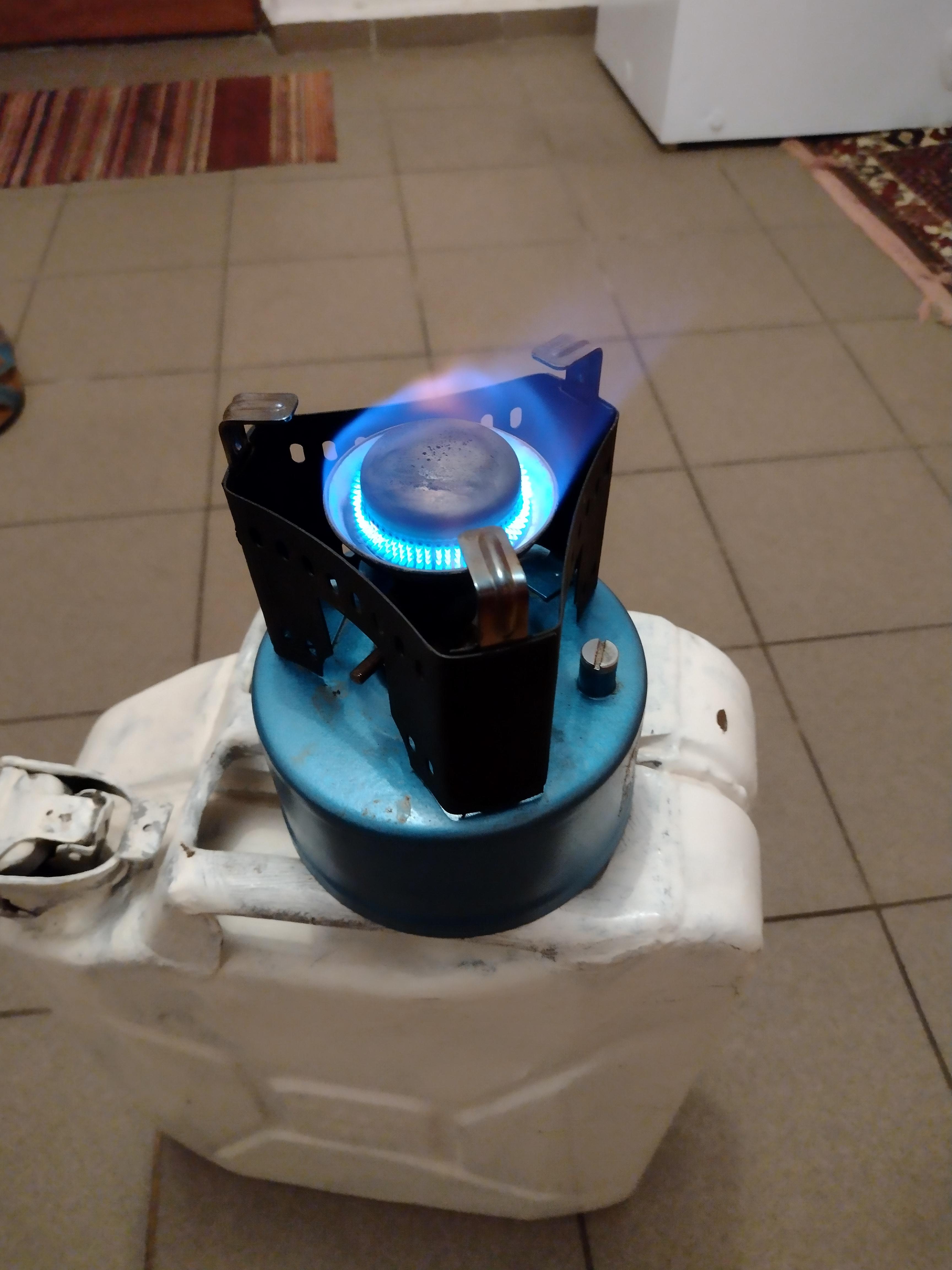

By the way : don't mind me too much.
I'm a hydrocarbons fan and pyromaniac
I make my coffee on a gasoline Shmel-2 burner stove
Shmel is also a russian thermobaric rocket .
Not to be confused
