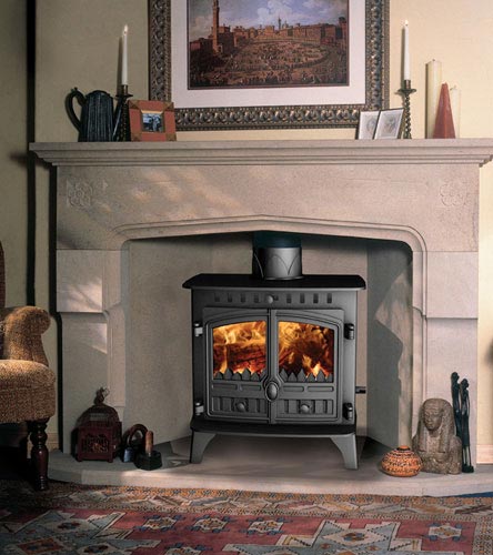

I don't know the particular stove but woodburners don't tend to use a grate; they burn on a bed, the grate being for coal burning. Can you remove the grate and burn on the bed? You'll need a bed of ash to start with or, officially, fire sand.
Or have I completely got the wrong end of the stick?
David - we run the Hunter Herald 8 for all our home heating and bought a "wood-burning conversion kit" for £30 or so from Stoves, wood burning stoves, woodburning stove, multifuel stoves UK when we bought the unit. It consits of a replacement front section and some fire bricks. I haven't fitted it yet cos we can fit plenty of logs on, switch over to a bit of smokeless for night we we feel like it and the grate/ashpan make cleaning it out easier!
