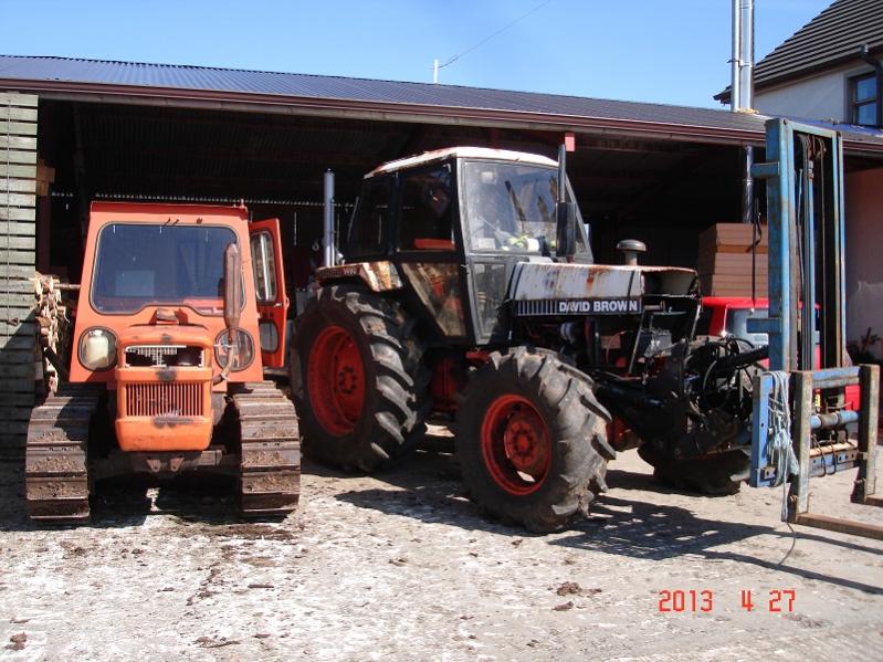

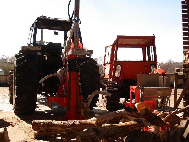

The luxury of 2 PTO's to drive my splitter and saw side by side.
see att.
My next "project" is to mount both items side by side on a frame, driven off one centrally mounted PTO stub with suitable pully sizes so as to allow the Fiat to power both at about 1000 engine rpm on the 540 shaft.
The old DB has the benefit of a 1000 PTO setting, but I need her for off road forklift duties.
With perhaps a home made "bundler" on the back for my 1.0m3 round bundles of 1.0m long billets.
Hydraulically clamped and tied with 6mm blue rope.
5976648754c70_Apriland1stMay2013005forintersnot.jpg.c7dc0deb436a57b22cb36ab4b9ba240f.jpg
5976648752464_Apriland1stMay2013002forintersnot.jpg.0be4055eea96177d198ac16b5f9f69d9.jpg
