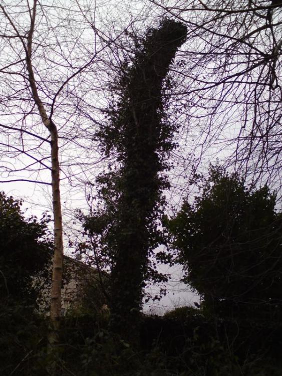

took these photos for you today mate, the first is pretty obvious.
blown over years ago and cut off and has grown well, i have known this tree for ten years and it is excellent.
the second i halved 10 years ago. it is about 30 feet high now. the tree was originally covered in ivy so when i left it it was just a stick. the pic isnt good but the tree is about 2 foot across.. look at her now. hope this helps.
