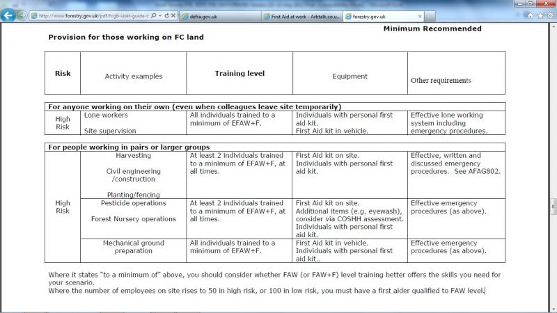

I think you only need the full 3day if your managing over 50people you should be ok on EFAW+F
This is the table from FC guidelines as you can see for harvesting ops where there are two people minimum you should have EFAW+F (1day) if you deem you need the FAW+F (3day) then its your decission, but my understanding is that for most forestry ops the 1day is sufficent as long as you have multiple qualified persons on site.
