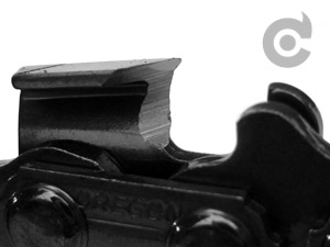

I'm intending to pre-order a couple of Tsumura Pro Solid bars off you for my 560XP, (15" & 18" @ .325 / .058.)
Could you recommend me the best value for money chain to run on them please? I'm doing sweet chestnut coppice & smallish broadleafs.
I'll eventually set myself up to buy reels and make my own but it'll have to be pre-made loops for now. I don't want cheap crap but I'm wary of over-speccing as well.
Any suggestions?

Hi Ben - I'm really not a guru of much of anything!
Oregon chains are the benchmark chain ie. good value good quality - I'd go for either the chisel or more likely the micro chisel [less prone to dulling and sharpen easier].
Best thing ref saws is keep going back to how to improving general maintenance and sharpening. This can always be improved and will always pay off.
