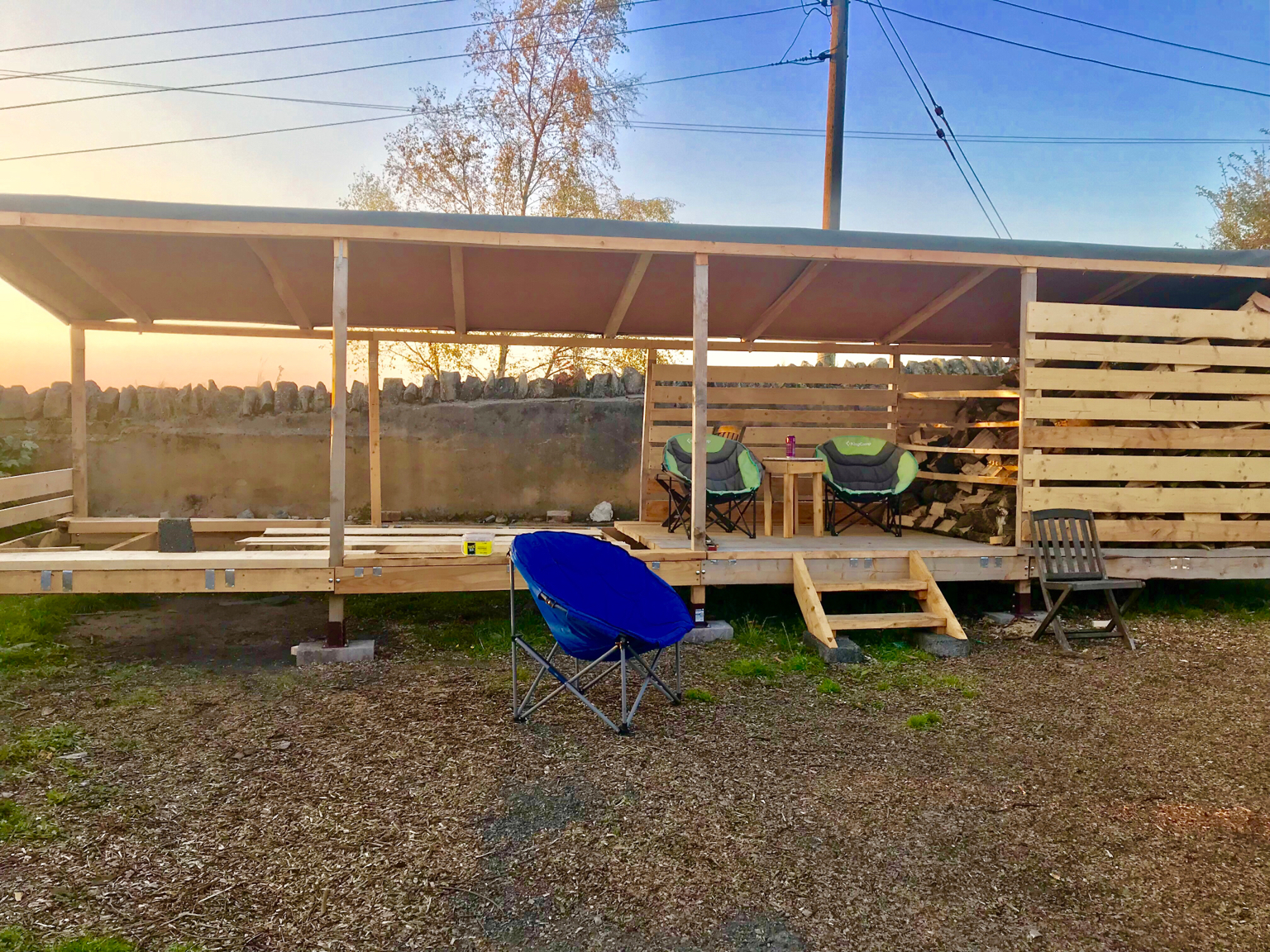

Necessity and endless supply of wood coupled with high price of preservative has meant in the past 12 months I’ve built a lawnmower shed, a shed for my chipper and a drying deck, all with green wood and no issues whatsoever. I’m gonna build a man shed with seasoned wood but thought I may as well go ahead and do some decking with fresh spruce. What’s the worse that can happen?
Oddly I had toyed with the notion of simply affixing the fresh cut boards, with a screw at the bottom only, and a more generous lap/overlap, then put the rest of the screws in after it had weathered/seasoned.
But I chickened out.
I shiplapped the lawnmower shed with 1” thick spruce and no significant warping after a year. Still water tight
I did have to reposition the padlock bolt by less than a cm though
My half finished drying shed, all with green wood bar the roof. As soon as I mill it I fix it. The middle two decks for drying timber, the ends for logs
Will have it finished in 3 more trees[emoji41]
