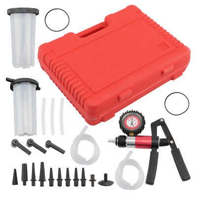

I have a Mityvac and also this one below, I have saws in this country and abroad and use this one when I'm there, a few years old and to be honest it was well worth the money and has paid for itself many times over! it's aluminium construction. you see some that appear to be the same, but take care, they only do vacuum, just look at the pictures of the gauge and you will see either vacuum only or pressure / vacuum
WWW.EBAY.CO.UK
22pcs Brake Bleeder Tester Tool Kit Vacuum Pump Motorcycle Bleeding Hand Pump. Suitable for checking pressure and vacuum systems such as: Checking charging pressure...
WWW.EBAY.CO.UK
Actually bought this and finally got round to pressure testing, blocked it all and couldn’t get saw to hold any pressure whatsoever
(yes did confirm tool was holding pressure and my adapters were)
in the end I put my air compressor on it and very quickly came to conclusion clutch side crank seal is shot to bits.
oh I can also turn the saw over by hand on just the flywheel with everything blocked off -  can hear the air being pushed out the seals
just need to get some new seals ordered and figure out how to get old seals out.
