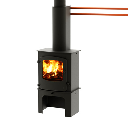

Another thought would be the Charnwood flue pipe boiler,   this will only fit some Charnwood stoves only and no others as they use the flue flange fixing points.  One of those fitted to the new Aire 3 ( not sure off hand if Aire 3 would be compatible though) would generate around 3kw to the room and 2.7kw to the water,
