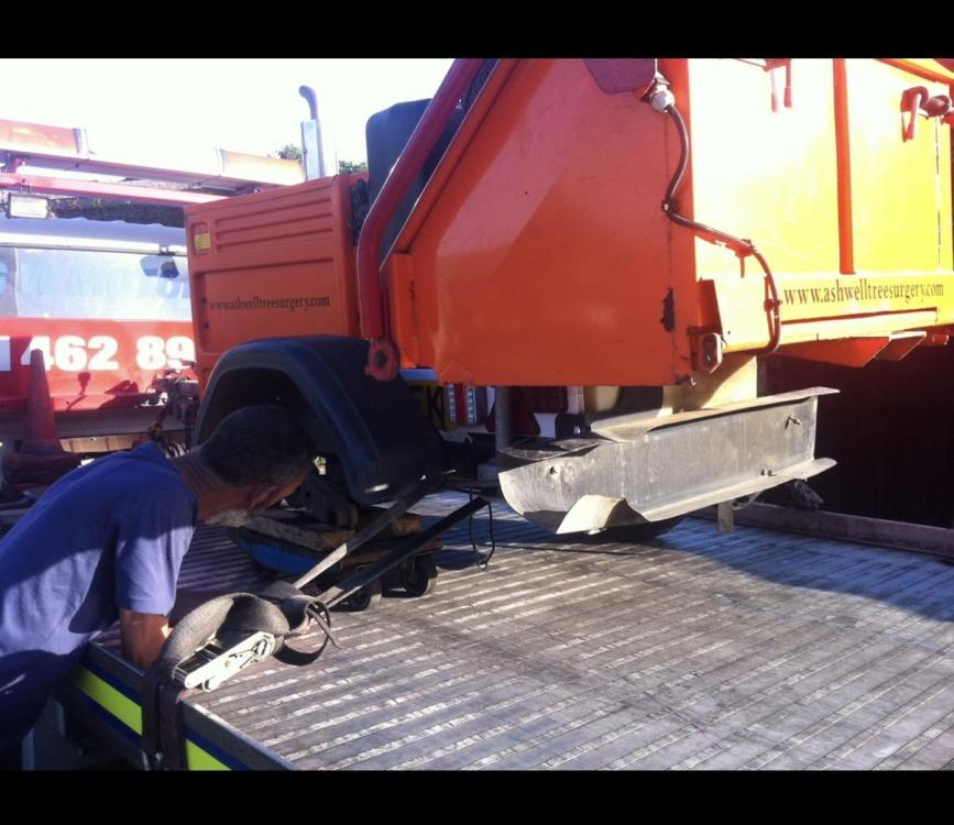

I’ve just had a wheel snap off on my Timberwolf 150 dhb 2007 model. The chipper isn’t with me at the moment and I’m trying to source a replacement. Western trailers need a plate number for its specs.
Any ideas?
They used different chassis and axles through production but I think the later sub 750kg had alko axles from when one I had snapped.

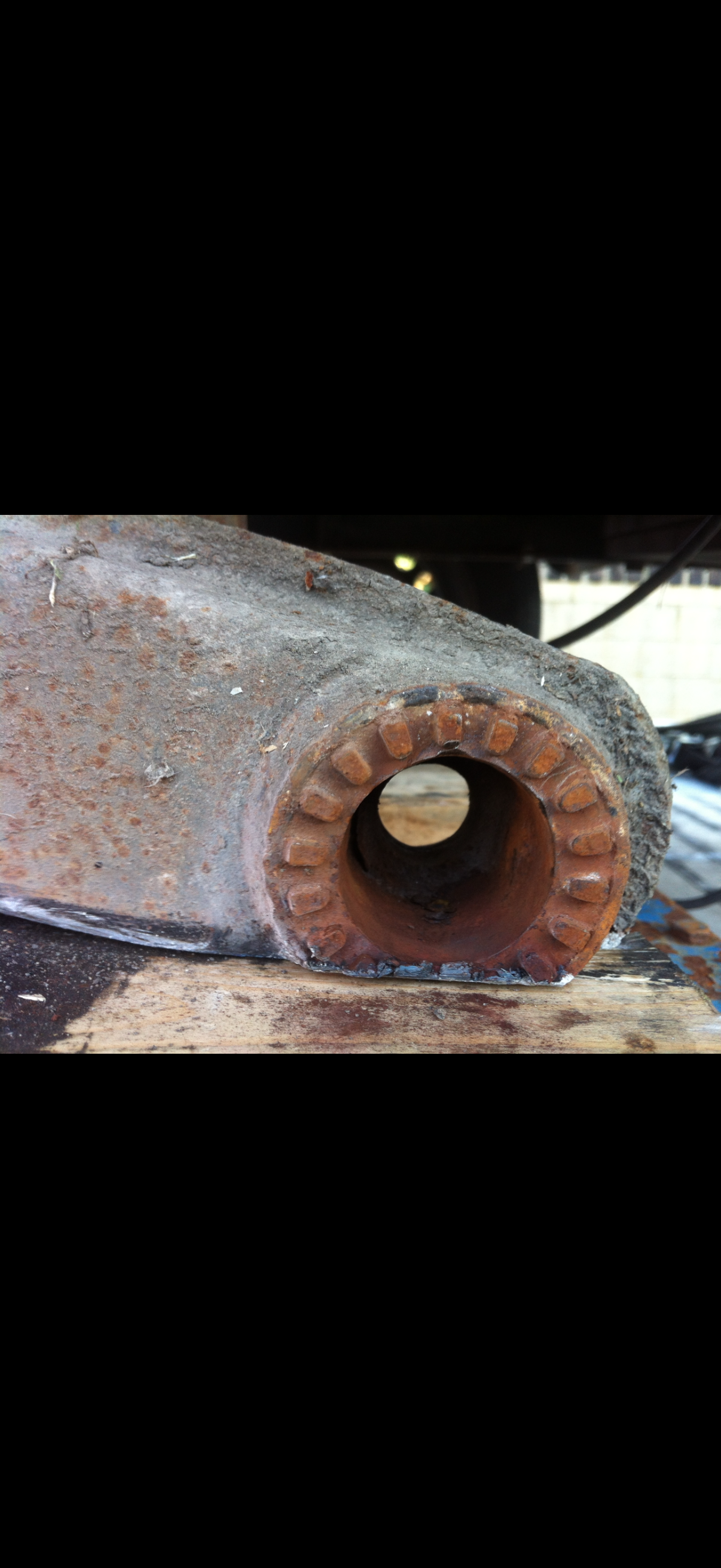

I doubt it, they were pretty notorious on the sub 750 to do this …
Certain swearwords come to mind at that abomination.
Guessing the bolted on wheel shafts didn't have a castle nut ?.
