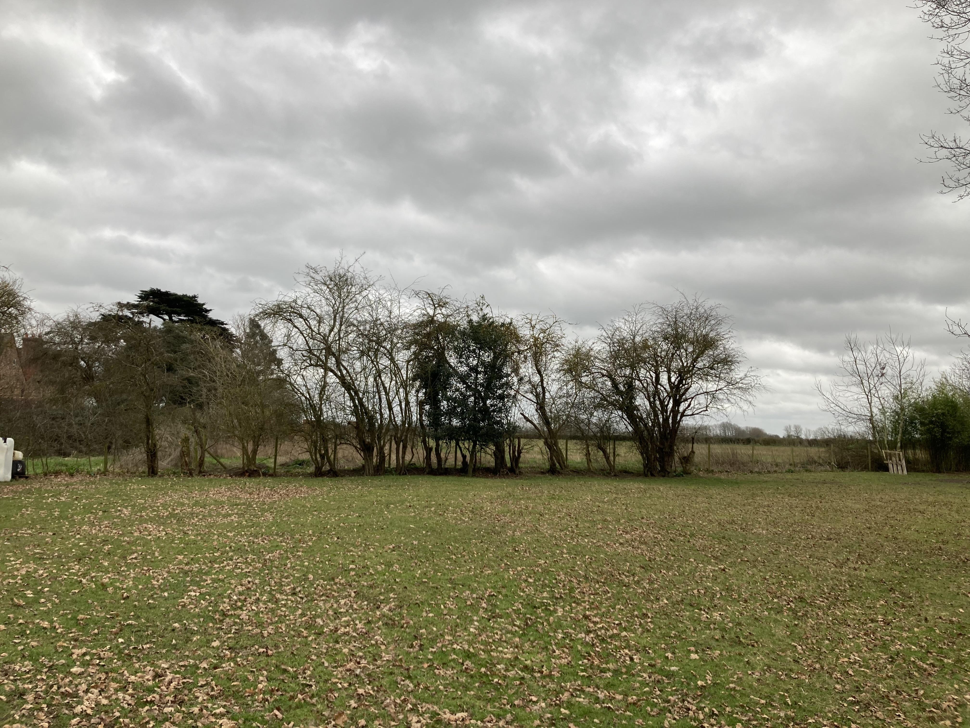

Still pottering round at the parents’, learning on the hedges here, broadly safe from public ridicule. What to do with this one? My summary of the internet suggests coppice it, pull out the elder, plant gaps and the blank stretch, fence the sheep off it and hope to lay it in a few years. Or should I saddle up and put the big ones down as is?
For goodness sake lad, get your saw fired up, and get it layed, pronto !
If the pleachers look too heavy to hold on your own (and you can't manage to persuade anyone to be your assistant for an hour), then just cut the top out of the pleacher FIRST of all ?
It means that you'll be laying a shorter length of 3-6' Hawthorn stem, but with a few finger thickness branches still attached to it, ideally..
It will still sprout vigorously, in a few weeks .
Hope that makes sense?
A layed hedge is so much richer, for a whole host of ecological perspectives, than one that's been coppiced off!

If there's too much basal decay on the odd pleacher, then just get your spade out, and root-lay it over (bonus: even more micro-habitats created!).
I would concede, if I was pricing up laying several hundred metres of your hedge, hypothetically, then, yes I'd be wondering about bringing in a 360° machine.

What’s the craic with elder? My appraisal is it’s bad. There’s a different bit of hedge here where one has shaded a large hole out. But on this stretch in question there are a couple of instances where it’s elder or a ten foot gap. Easy lay now vs problems later. Probably not the first to face that dilemma.
Elder is bad news in a hedge. Out competes for nutrients, smothers and kills off other species. I always cut it down the the ground and spray the stump with glyphosate.
Usually a sign of poor hedgerow management if elder has got a foothold. Desirable species beaten to death with tractor flails creating weak leaf cover and gaps. Elder moves into these spaces and rapidly colonises the whole hedge so it's nothing but elder.
Elder is a fascinating species. Surrounded by myth and folklore and hosts an enormous variety of other life. But best a stand-alone tree in open space or a spinney (same as blackthorn) where it can do it's own thing. Not in a hedge.
