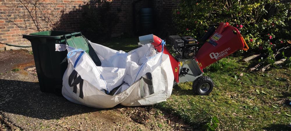

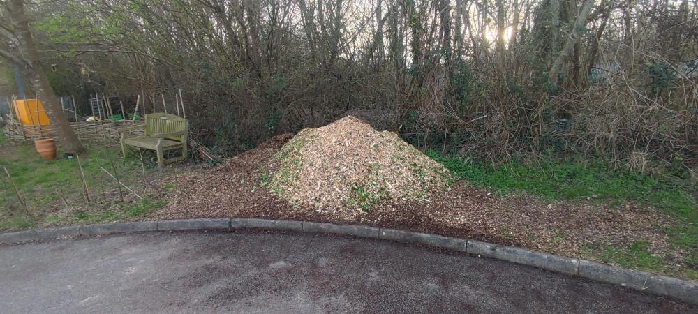

Full width chippers are not going to get into a back garden and chip where it can be left. This is more for small solo jobs where I can chip under the trees/hedge to leave it as mulch, as a way to deal with waste and keep my price affordable.
For jobs big enough for a full size chipper and tipper to take it away, I'll quote extra to get somone in. I'm not ready for that expense yet.. I have a job like that mext week, I'm not getting very much of the quote but with a small chipper I could do it all myself.
