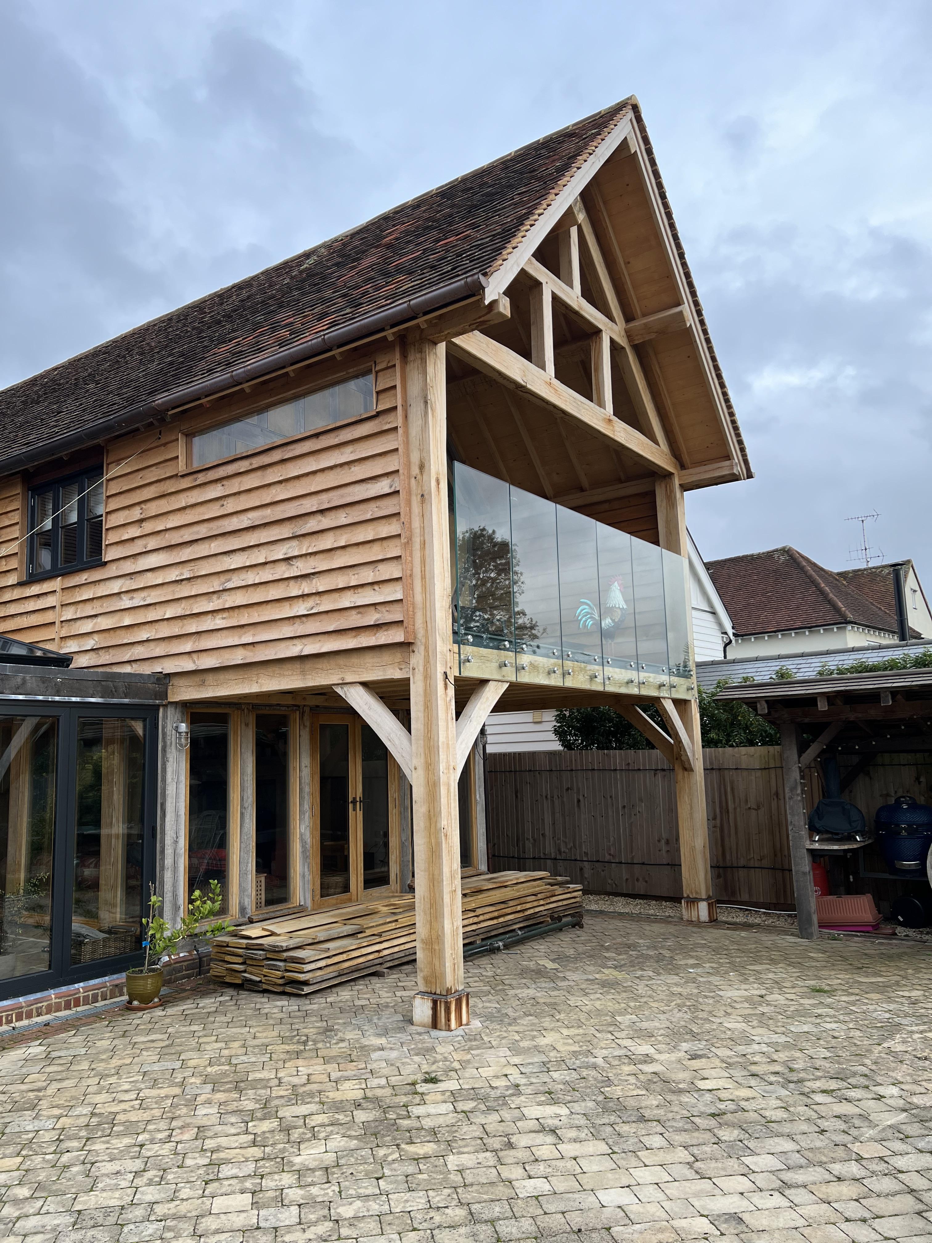

it was just the balcony - we couldn’t get building control authorisation for oak framing for the whole extension. Radical experimental technology.
I built my own oak frame med house about 12 years ago and just added a large covered balcony.
