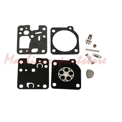

Nice thanks for that!.  Shouldn't that be rebuild kit RB-283 or am I missing something?
283 doesn't look right. That page from Zama lists 188 as the right kit, and everything on the exploded diagram matches your pics. Other than that, i don't know.
Yup, the carb is a Zama ZO11 and happens to have "RB51" on it and Zama use "RB" to denote a carb kit hence the confusion.
The metering diaphragm looks like the early C1Q ones used on the Stihl 020T and others, that is a common part as will be all the metering parts as many of the Zama and Walbro carbs use the same parts - no need to reinvent the wheel on each type of carb!
Looks like Ratman beat me to it.
