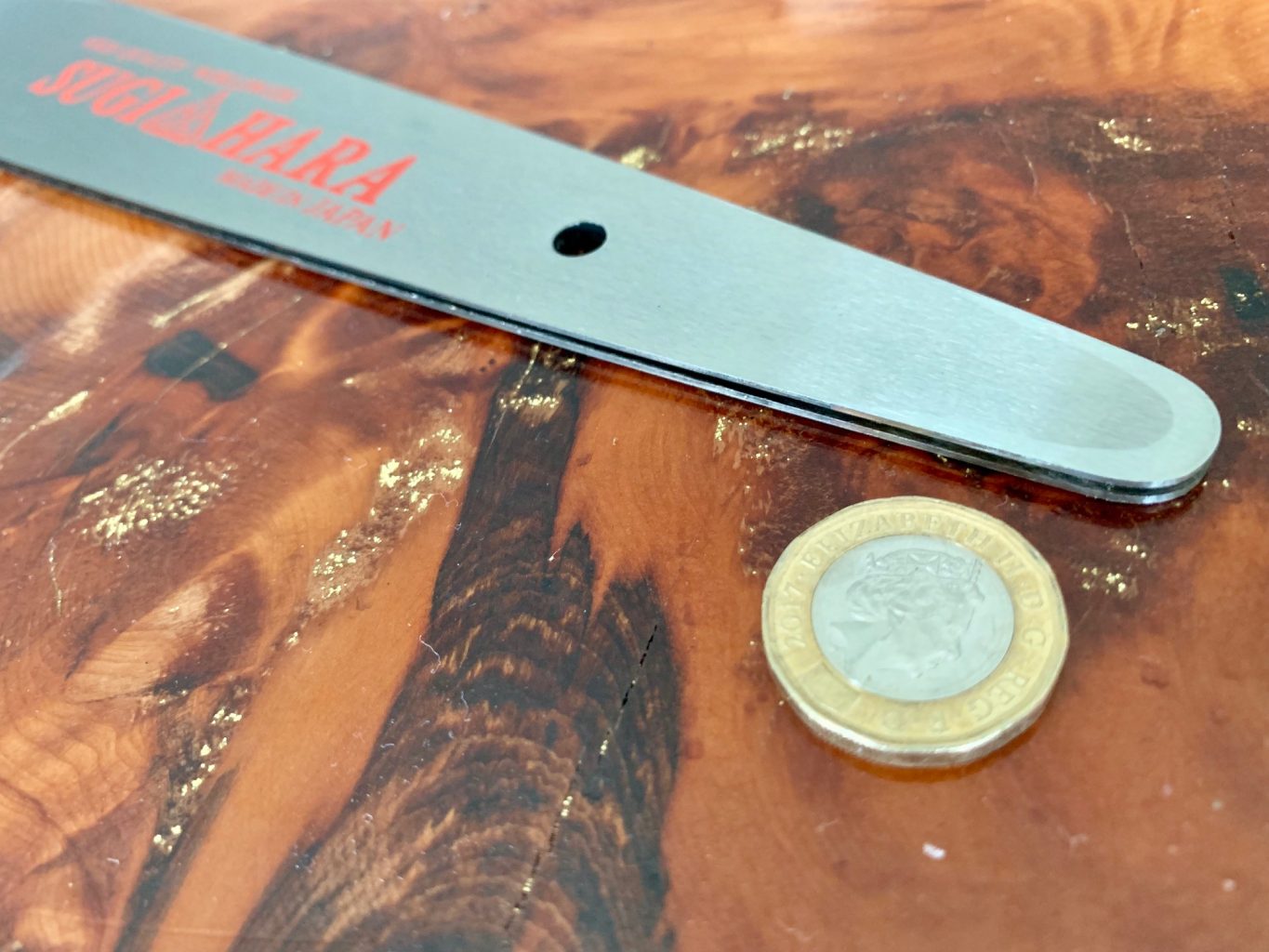

I’ve got a Canon 8” and 14” which I use on MSA160 and MSA200 respectively . They seem to run well and I find the 8” especially good for fine work. However I prefer to use the Sugihara R7 12” ‘tough carver’ bar for most of my carving. They are designed for the Stihl saws.
Rob at Chainsaw Bars sells them.
WWW.CHAINSAWBARS.CO.UK
SL2A-4P25-A [Stihl Only] Sugihara Tough Carver R7 Tip 10" 1/4 .043 56 drive links

The stihl carving bar fits it as does a sugi hara carving bar in 10" and 12" both from chainsawbars. The 16" sugihara won't fit it because it doesn't have the open end.
